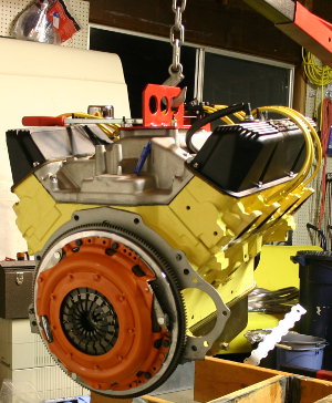

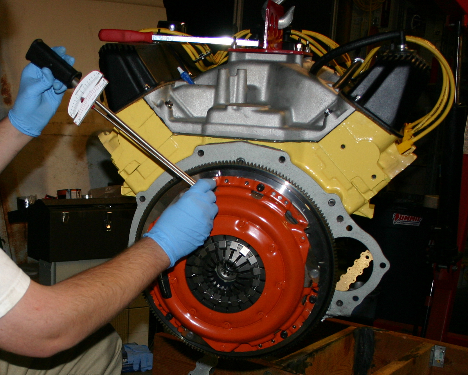

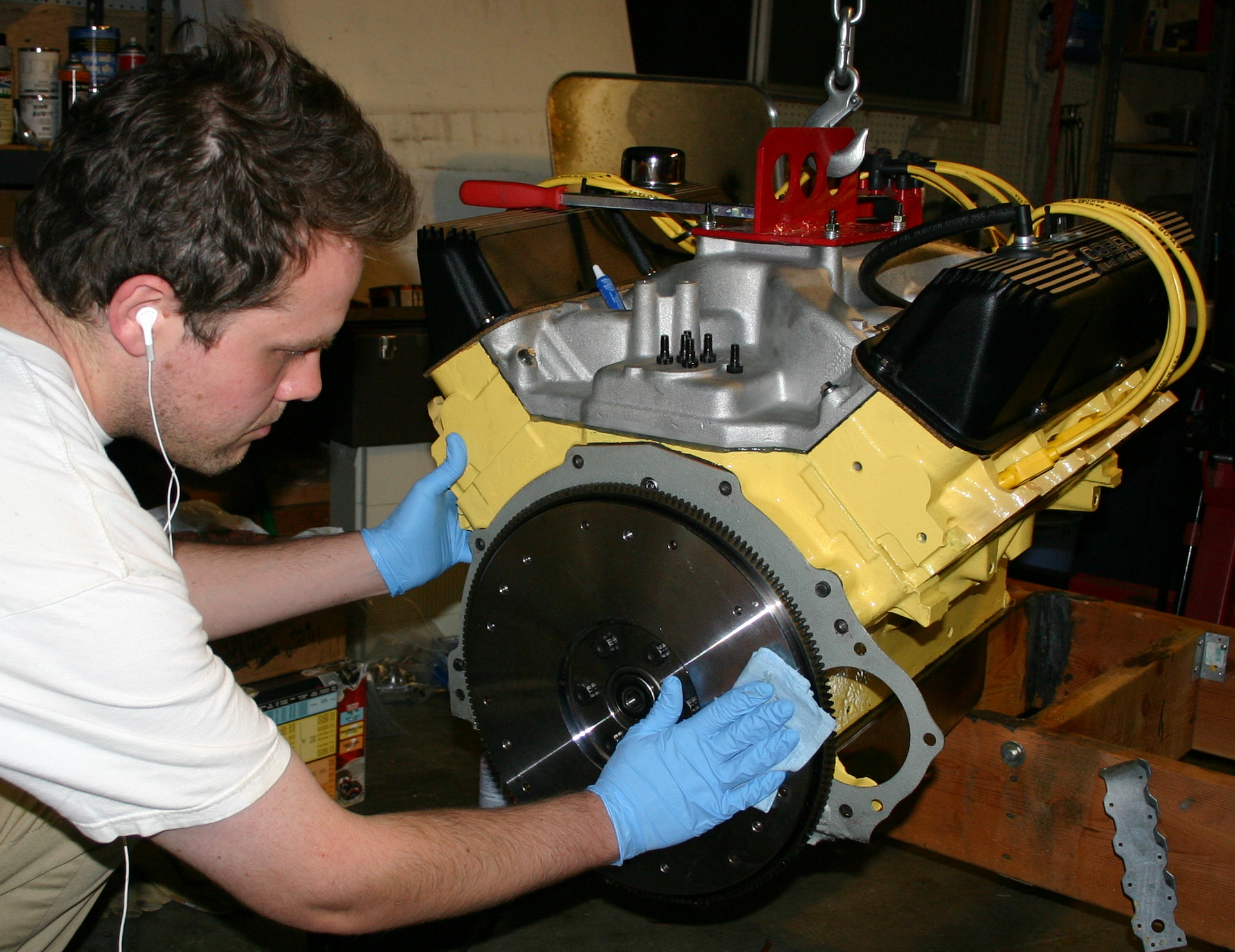

I installed the flywheel for the final time, stepping up the bolt torques carefully to 80 ft/lbs and using red thread lock. I also paid a lot of attention to the bolt lengths, and I'm happy to report that they're the ideal length. They have complete thread engagement without sticking out on the front side of the crankshaft flange at all! Here I am getting the flywheel immaculate with brake cleaner.

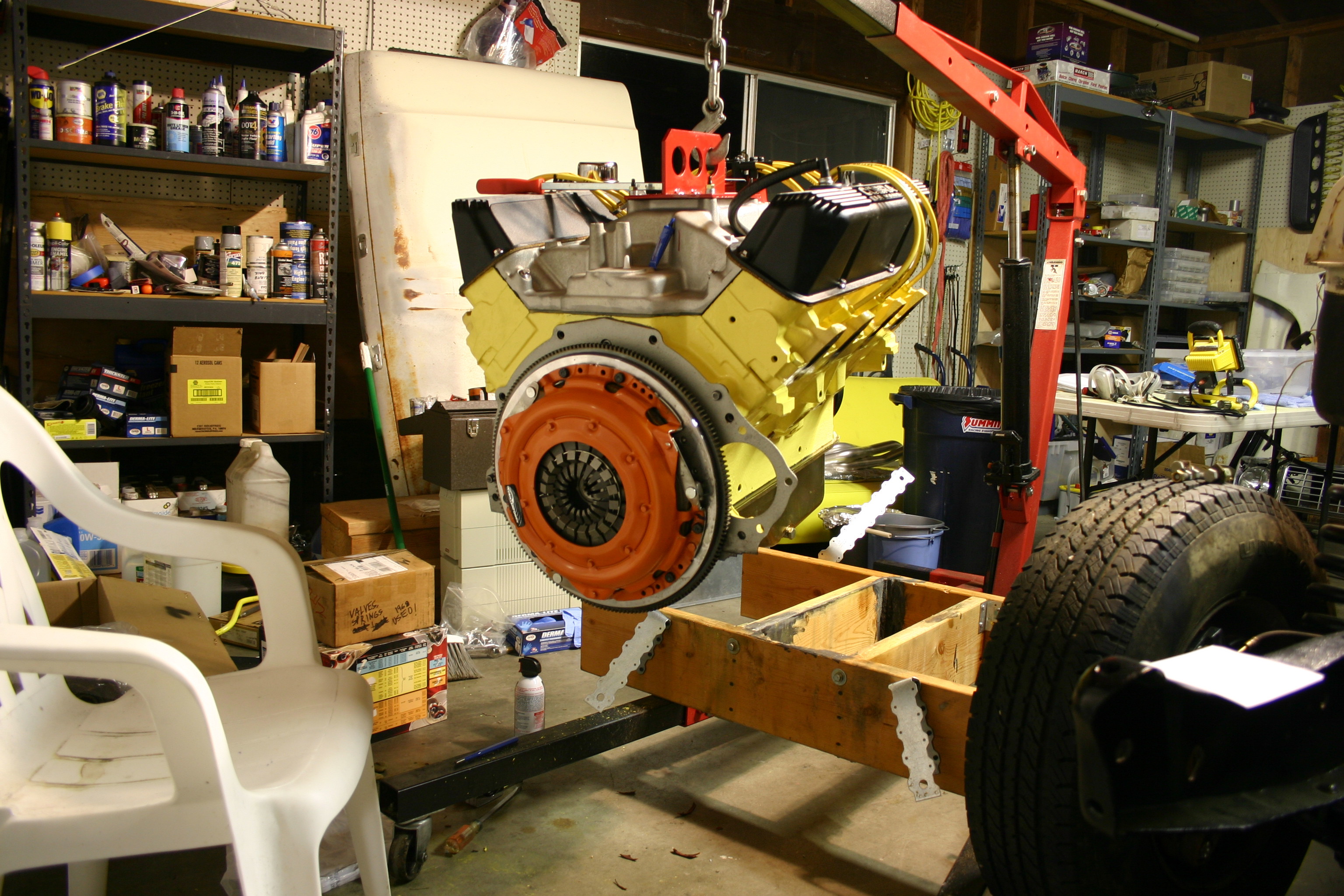

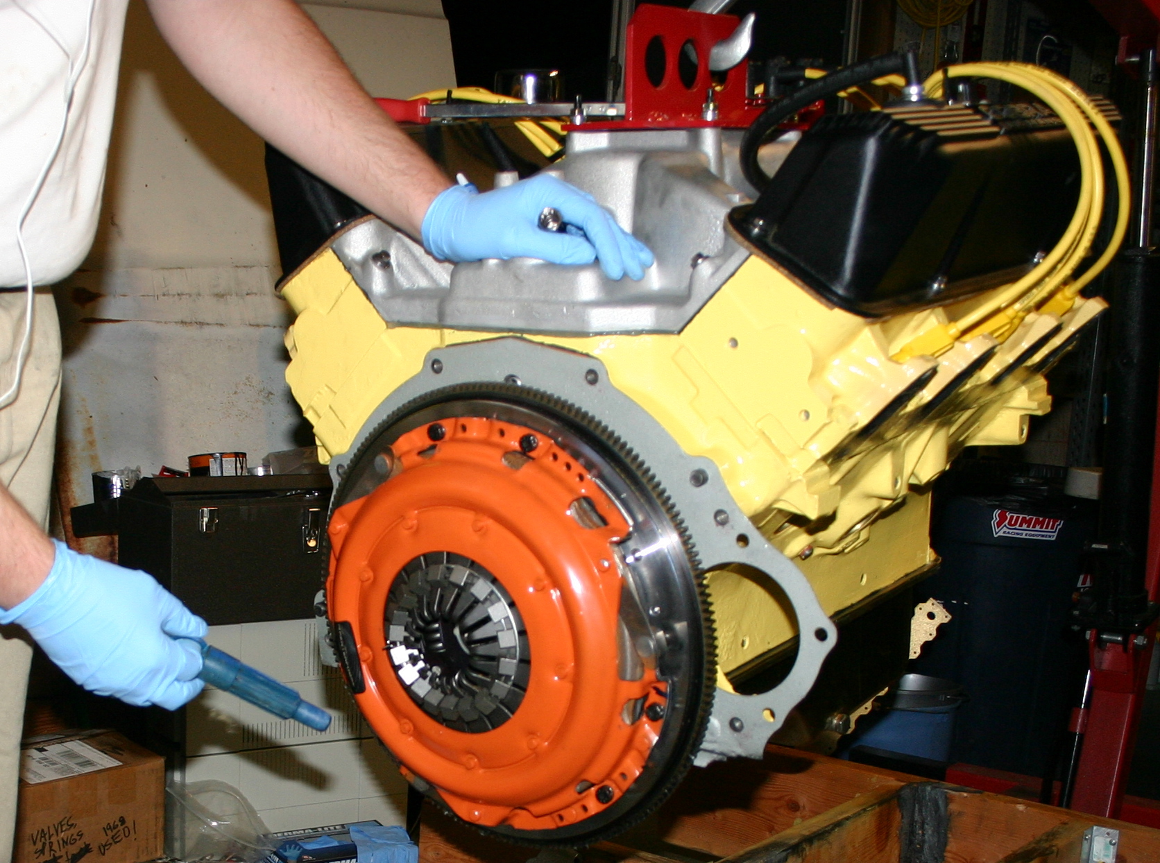

With the cumbersome job of installing the clutch and pressure plate complete, I removed the clutch alignment tool. As documented in Pilot bushings, bearings, and bell housing alignment, I used my modified alignment tool here--I had to reduce its diameter slightly to slip in to the pilot bearing.
Then I torqued the pressure plate bolts down to ~28-30 ft/lbs. Thanks to Frank and Fordman for their great advice in Torque spec for pressure plate bolts?
I used red thread lock on these bolts too, even though their torque value's a lot less. The particular caliber of red thread lock I have is the mellow variety (it's not the strongest available), and they were easy to remove after the first time around (last time I pulled the engine).

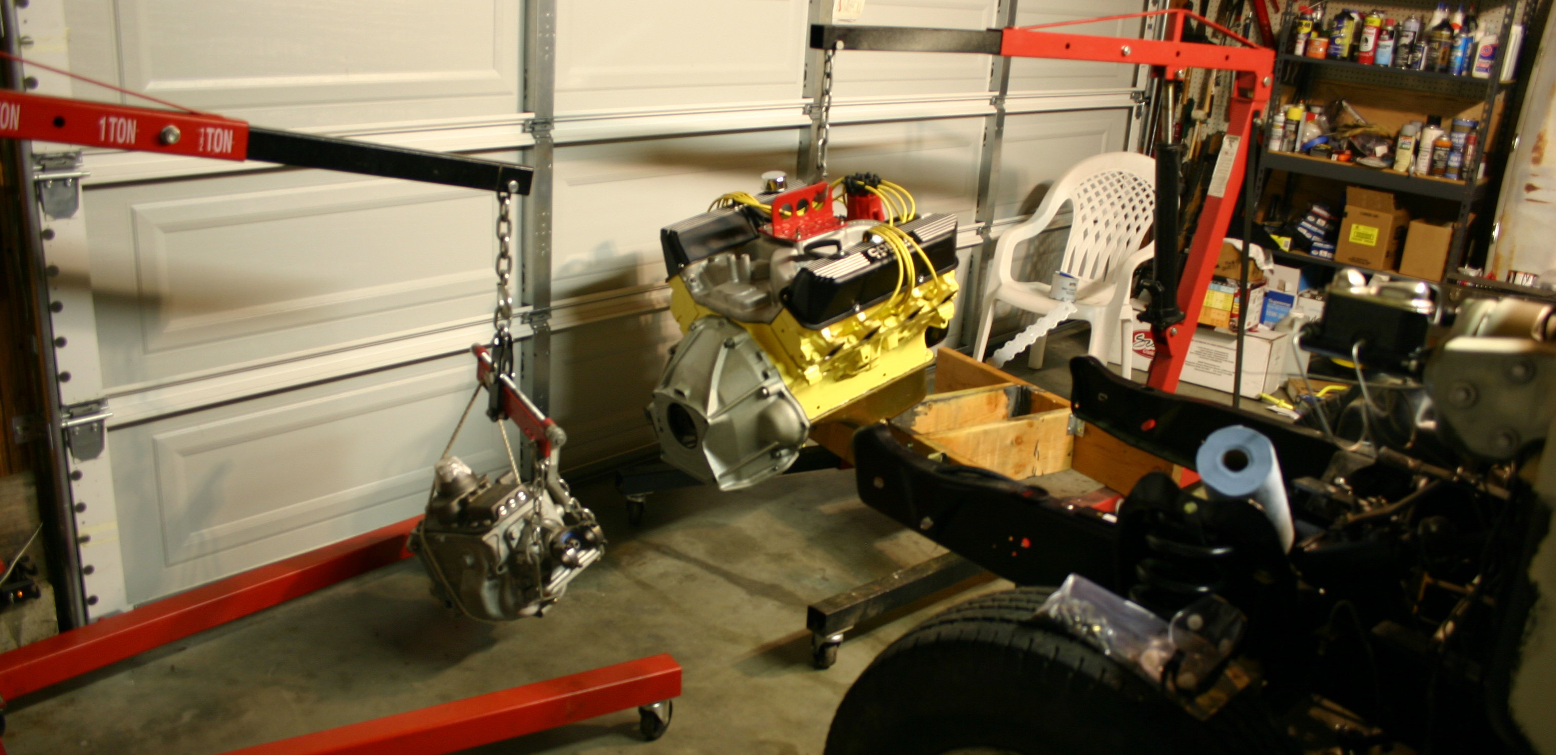

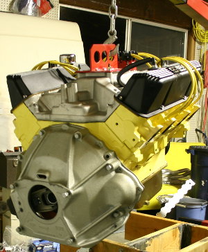

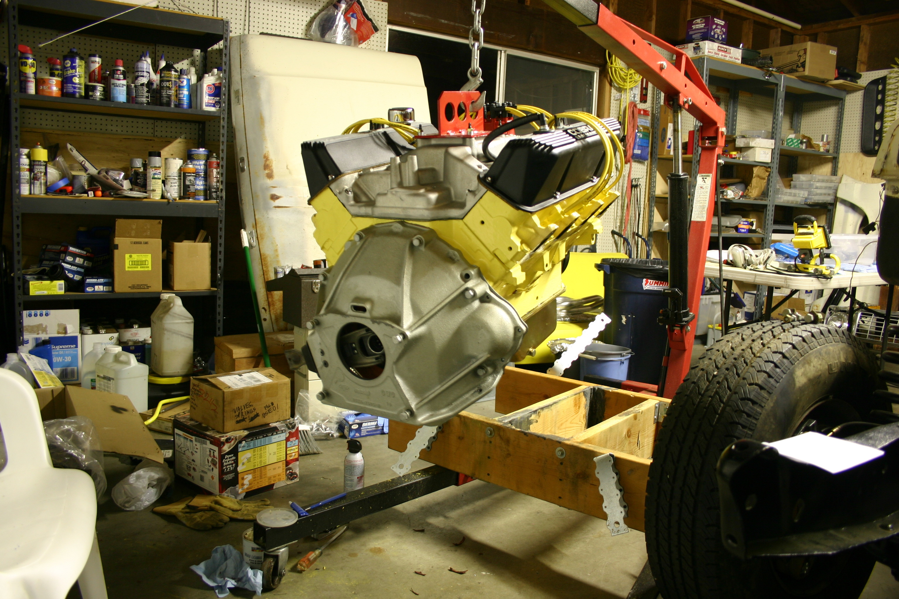

With the pressure plate complete, I did the final bell housing installation. I torqued its bolts to 40 ft/lbs.
Then I wheeled the engine and transmission nearby one another! Tomorrow I'll stab 'em together.

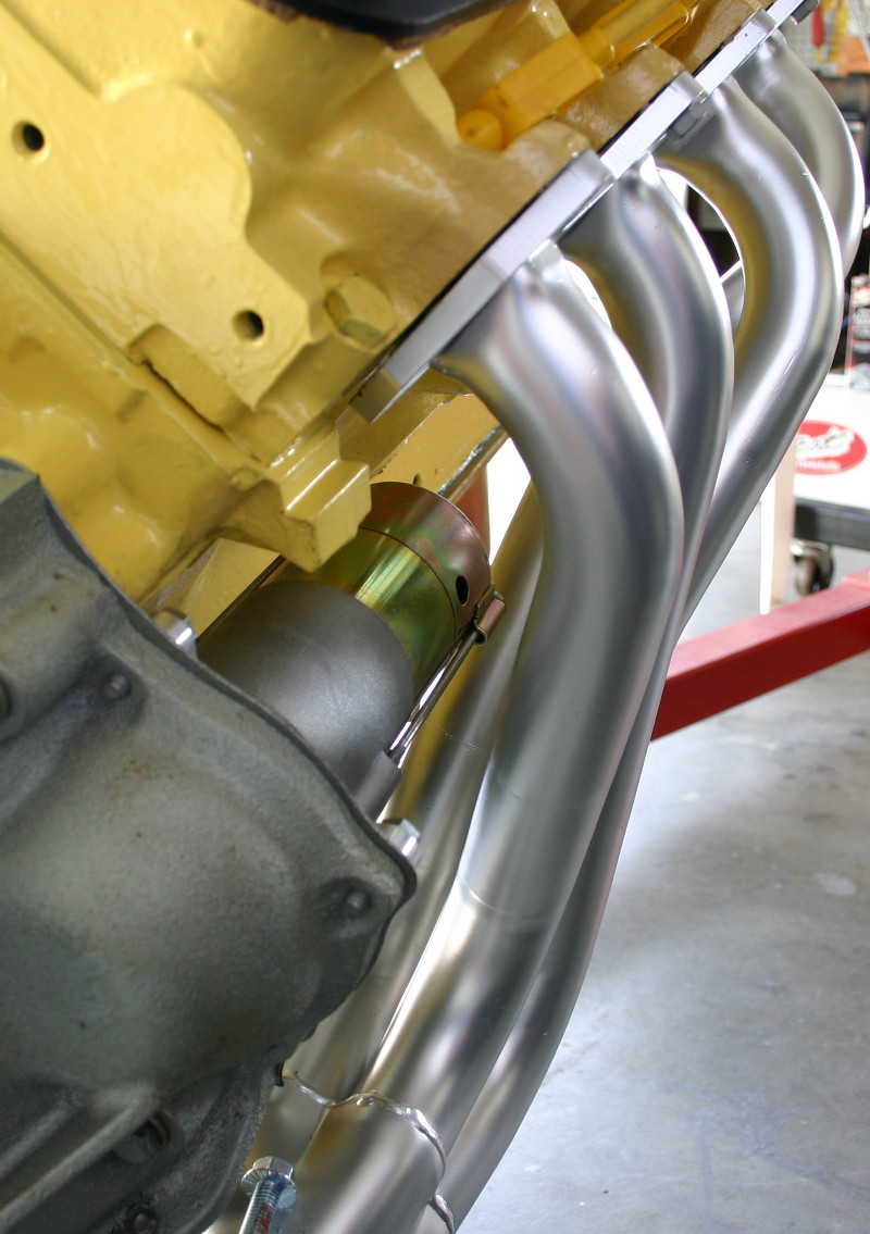

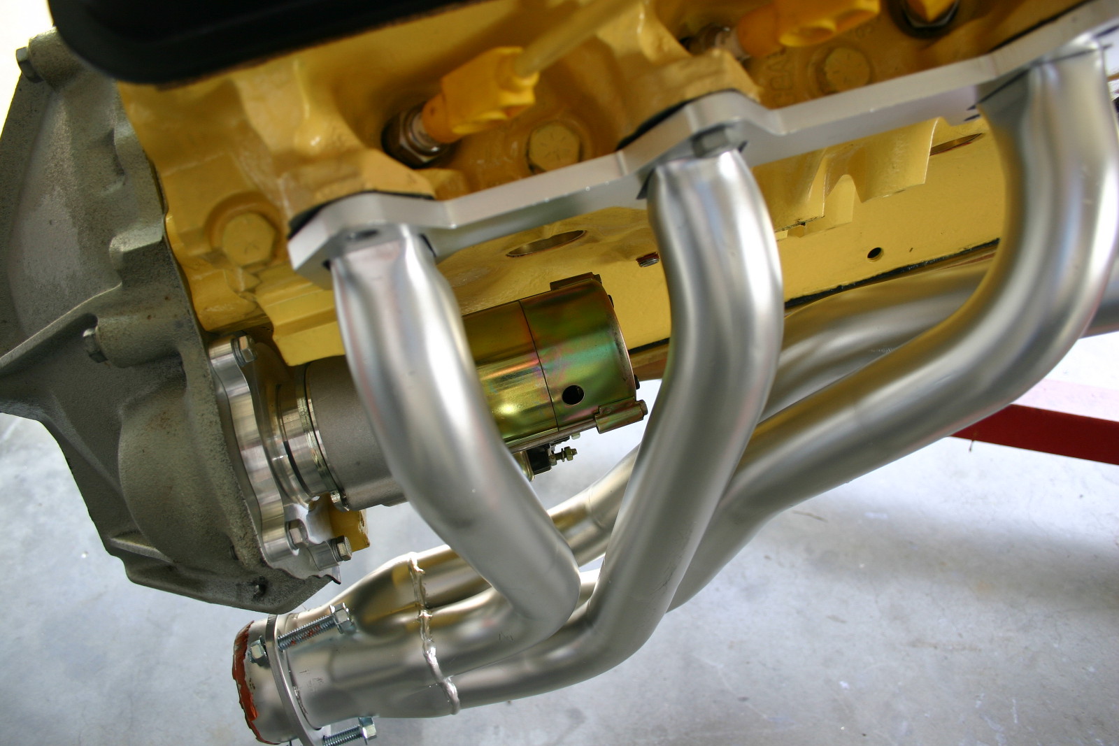

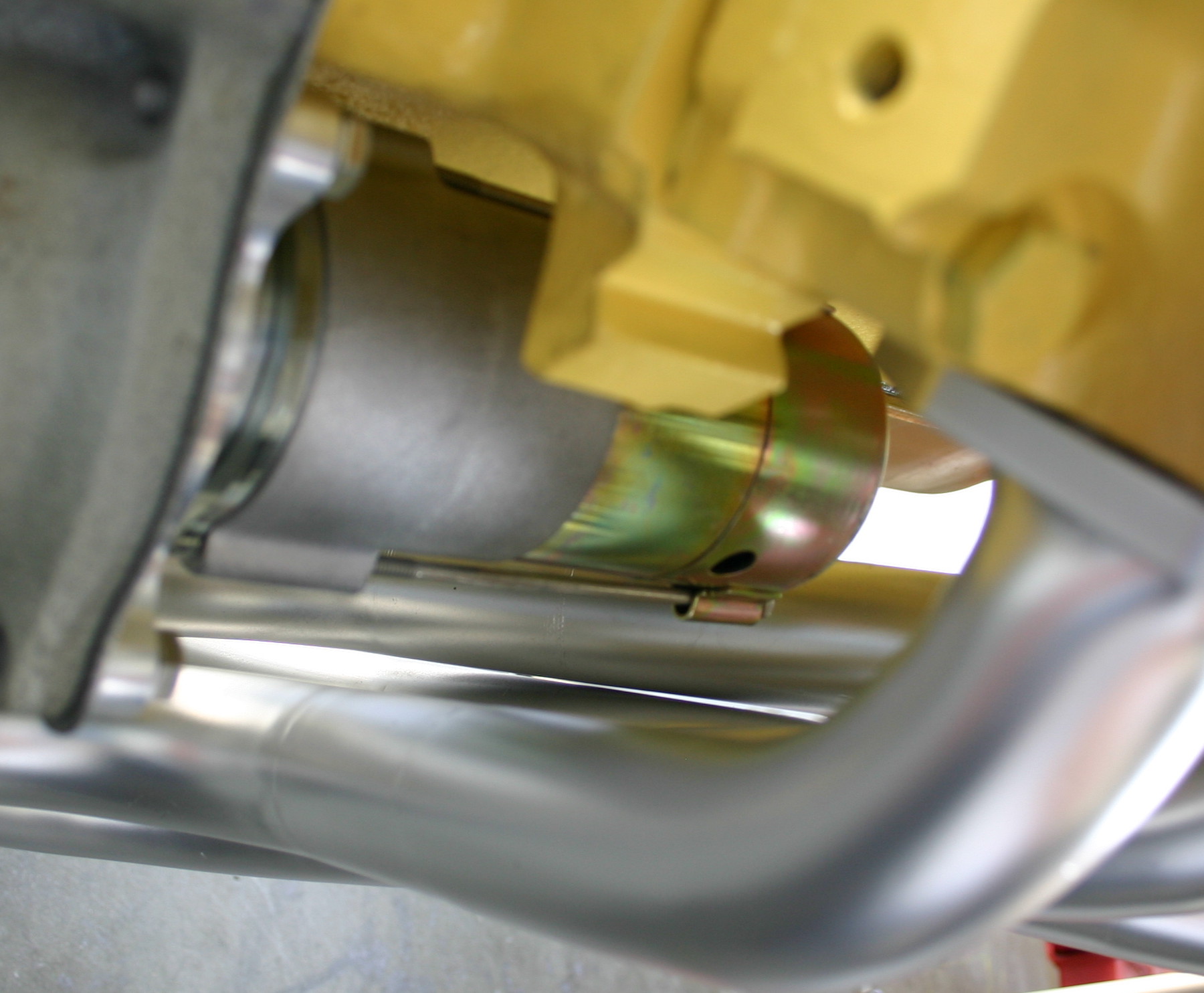

One suggestion since you are this close;
Since we read about headers eating starters so often I would suggest mocking the headers and starter now and checking the clearance between the headers and starter. This is an ideal time to fab up a heat shield to help protect the starter from the header heat so this may actually be the 'final' time you put it together. At this point you can easily drill and tap the cast iron bellhousing lip around the starter for a couple 1/4-20 bolts and cut a sheet of metal 7"x8" and bolt it on.
Simple and effective.
That's an excellent idea! I gave this a whirl today (more later in this post).
Ranchero50 wrote:This is an ideal time to fab up a heat shield to help protect the starter from the header heat so this may actually be the 'final' time you put it together. At this point you can easily drill and tap the cast iron bellhousing lip around the starter for a couple 1/4-20 bolts and cut a sheet of metal 7"x8" and bolt it on.
That sounds like a smart idea!

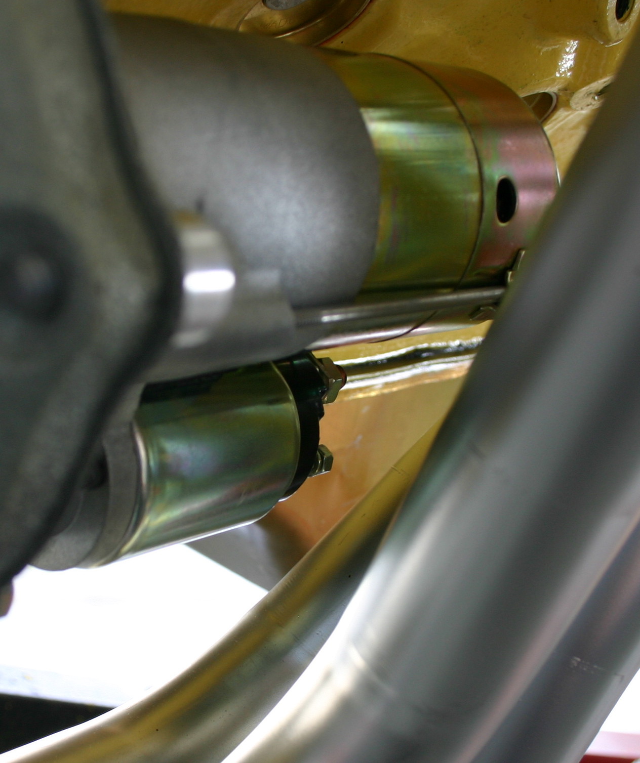

Today I wrote Robb at RobbMc about the starter heat shield idea. I've heard that the RobbMc starters are highly resistant to heat problems, so I wasn't sure how necessary a shield was for it.
Robb himself replied right away as he always seems to (amazing service). I read in his mail that if I have at least 1/2" of clearance all around the starter, and especially the starter solenoid, I probably don't need to worry about heat shielding. I also read that if I have 1" or more of clearance, a shield's certainly not necessary.
I measured the clearance and took some photos. The clearance ranged from about 1" to about 1 and 1/2", depending on where the measurement was taken! I sent the photos to Robb and he said that a shield's unnecessary.
Robb also mentioned that if I were to install a shield, the shield should be as close to the header tubes as possible, to provide for maximum air flow around the starter--interesting!

It was indeed a great idea! And I'm sure that with a regular starter design, it would be necessary. Yet it seems from Robb's response that this RobbMc starter doesn't require a shield at all, especially with the 1" to 1.5" clearances I have all the way around it.
